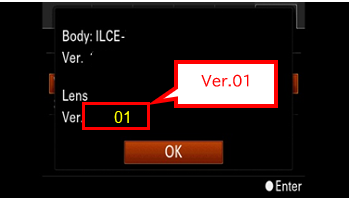

Check the System Software Version of Your Lens
Follow the instructions below to check the lens system software version:
  1. Select MenuSetupSetup OptionVersion.
  2. The lens system software version is displayed.
Poznámky:
  • If the system software version is Ver.01, the update is required.

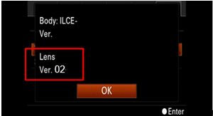

Step 3: Confirm That the Lens System Software Version Is Ver.02
  1. On the camera, select Menu SetupSetup OptionVersion.
    The version will be displayed in the center of the screen.
